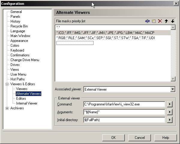

thank you for your quick reply. But that's exactly what I did (see attached image) - and it does not work, see my original post.
Regards, Manfred
- Alternate Viewer.jpg (52.43 KiB) Viewed 10430 times
- Posts: 5232
Yes, it is the problem. Please move your mask up, in front of *.*. Mask are executed top-down.
