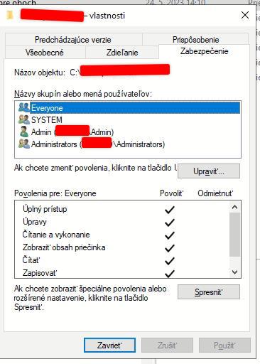

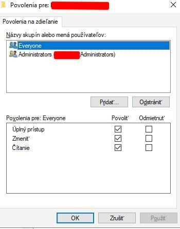

Using the direct address opens the shared folder in Salamander fine, but files still cannot be copied. Outcome is the same as navigating through This PC - Network.
Took photos of permissions for this folder.

Posts: 1181
Re: Can´t copy to shared folder
Check the access right on the existing subfolders too.
Change the owner of the shared folder to admin if it isn't and then let the access rights propagate to the existing subfolders.

The folder lies in the root of C:\ and has no files or subfolders inside. It´s completely empty at this point. If I try to copy something in Salamander, I get the blocked cursor thing and nothing really happens. I really feel this is a bug that ca be easily reproduced on a clean install of W10 64bit with latest updates and most recent version of Salamander. The network is set to be discoverable and everything works OK in native Explorer.
Is there a way to fill in a bug?
