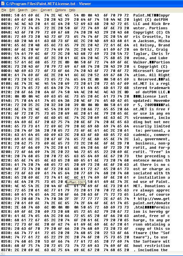

I think the size doesn't matter. I tested with 3 files: <1MB, 2MB, 3.2GB. Always the same. Under up to date Xp SP3 or Win7. And of course not cracked or something OS.
This is last line, where I can see the offset value. In line 270 or under I can't see this yellow popup "block".

Evin wrote:I think the size doesn't matter. I tested with 3 files: <1MB, 2MB, 3.2GB. Always the same. Under up to date Xp SP3 or Win7. And of course not cracked or something OS.
Ahaaa, the tooltip with offset doesn't get displayed. I think I can reproduce it.
It seems to me, that the tooltip does not display under rectangle of the size of "restored" (i.e. not maximized) window of Altap Salamander. Does that make sense?
1) have AS in a restored size
2) open the Internal viewer and slightly enlarge it at the bottom
3) the tooltip shows up only in the area of the original size
4) close the viewer, enlarge the main window of AS and repeat steps 2) & 3). The same problem with the new size.
5) close the viewer, maximize the main window of AS and repeat steps 2) & 3). The same problem, but the original size of the main window is still taken into account.
Re: Missing offset value in hex view (Viewer)
I can reproduce it, I'll look at it. Thanks!
I have fixed it, we have not set tooltip bounding rectangle properly. Thanks for reporting this!
