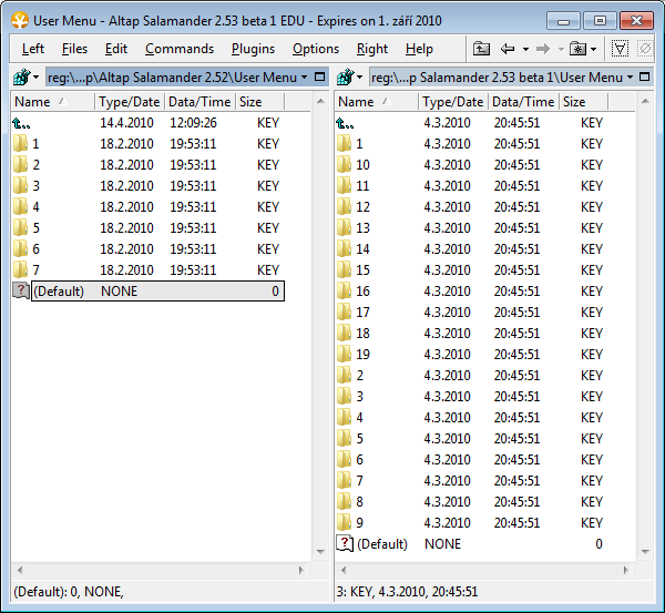

Re: Duplicating Configuration
jadag wrote:Can you guide me through the procedure to overwrite; reg:\HKEY_CURRENT_USER\Software\Altap\Altap Salamander 2.52\User Menu with reg:\HKEY_CURRENT_USER\Software\Altap\Altap Salamander 2.53 beta 1\User Menu
- Make sure no instances of AS are running and start AS 2.53b1.
- Copy this path into the clipboard: reg:\HKEY_CURRENT_USER\Software\Altap\Altap Salamander 2.52\User Menu
- Go to the left panel in AS and press Ctrl+V. The left panel should now show some folders named 1, 2, 3 and so on.
- Copy the other path into the clipboard: reg:\HKEY_CURRENT_USER\Software\Altap\Altap Salamander 2.53 beta 1\User Menu
- Go to the right panel in AS and press Ctrl+V. The right panel should now again show folders with similar names, but there should be more of them than in the left panel.
- Select all folders in the LEFT panel and delete them (don't try to delete (Default), it can't be done).
- Select all folders in the RIGHT panel and copy them to the LEFT panel.
- Close AS, start a new instance of AS 2.52.
- Enjoy.
