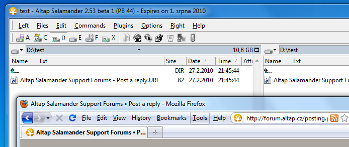

Jan Rysavy wrote:What URL are you dragging to Salamander? URL to some local file or to web page? Are you pasting it into the panel or to the Directory Line?
Its URL from addressbar in firefox (now 3.6, but also in earlier versions). it is (e.g.) address to web page. when I drag it and move over Salamander (file pane), an icon with "shortcut" appears, but by releasing nothing happens.
Usually (in explorer or TC) the shortcut is created after drag&drop.

Trying to create a shortcut by dragging the web site icon, which is next to the address bar in FF, to Altap Salamander panel does nothing. No crash at my PC, but no shortcut created either. Same thing works fine when using Internet Explorer.
I always do Shift+F3 to open explorer window, drag it there and then close - then it works, but it's ugly. I would be happy to hear any better workaround, as I store shortcuts in HDD folders instead of using "Favorites", so I need it often.
