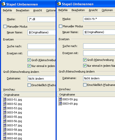

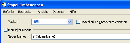

I was irritated by a strange entry (|*.dll) in the "Batch Renaming" mask. Today I found the solution, I've used "Filter" (STRG-F12) months ago.

this only happens when the filter is active in the panel from which you launch the renamer plugin. This is exactly what I would expect to happen. Otherwise I might rename unexpected files, because I did not see them in the panel I came from, that is, the set of files I usually want to process.

I realy think that this is a fault. Because if I use a filter in a panel, I can make my file selection for "Batch Renaming" only with the active filter.
The mask in the "Batch Renaming" Plugin is for the name of the selected files. For this reason I expect the Mask: "*.*" as the default setting.
Example for the use of mask (|*.dll has no function in the mask, but it irritated extremely):
