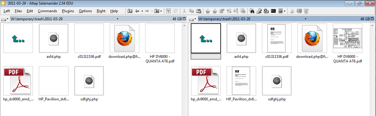

I don't know if PDF thumbnails are handled by explorer thumbnail plugin which I have installed or by AS itself, but today I noticed that I can't see thumbnails for my PDFs in AS
I opened explorer and everything seems fine there. Problem could be that I've installed IE9, but that's wild guess
Does anyone have same issue? Is it possible to solve?

Eroiica plugin works fine.SelfMan wrote:Have you disabled the Eroiica plugin?
I can partially confirm - I've got IE9 and I've disabled Eroiica plugin and my PDF thumbnails are blank. I don't have a system without IE9 at the moment, so I can't confirm IE9 really is the culprit.otrov wrote:Now I think I posted in wrong forum, as I'm almost sure problem is with explorer thumbnail plugin and IE9
Can someone confirm this behavior
Just post a link to this topic with a short explanation there.otrov wrote:moderator to move this to explorer thumbnail plugin thread?
- Explorer Thumbnails on the left, Eroiica on the right.
