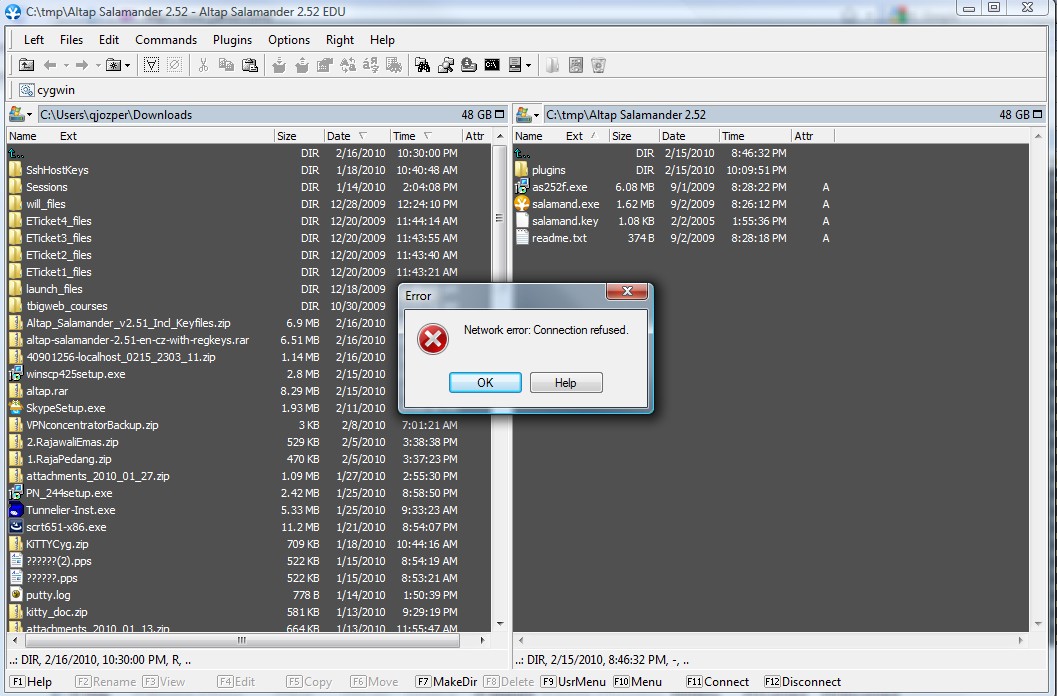

I tried SFTP with altap salamander 2.52 and got error, while working fine with Altap salamander 2.51.
Any idea why ?? and how to resolve it ??

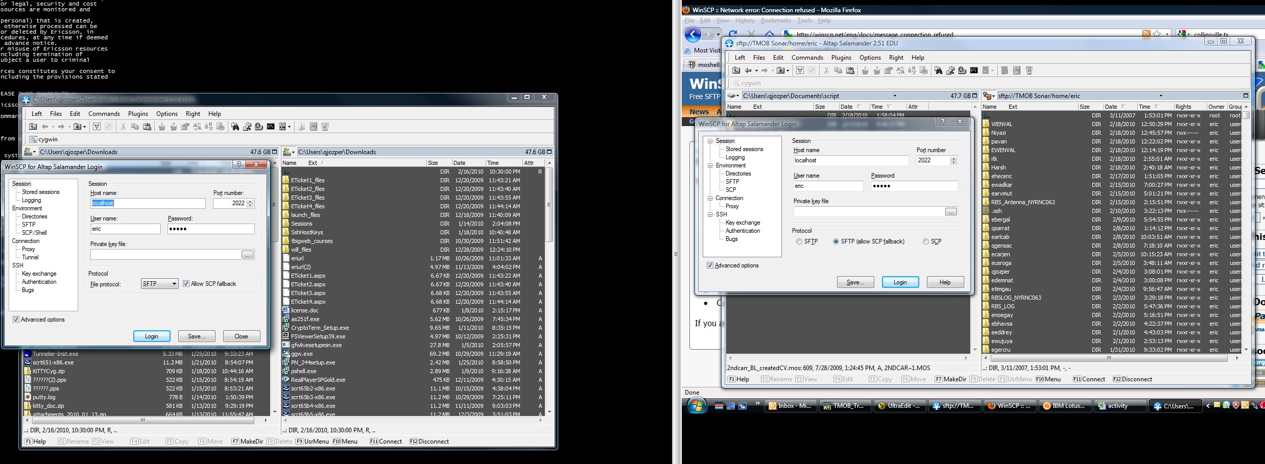

Attached comparison Altap 2.52 and Altap 2.51. On Altap 2.51, I tried SFTP, SFTP (allow SCP fallback) and SCP, all works, mean I can connect. On Altap 2.52, none of these configuration work, all with the same result "network error : Connection refused"

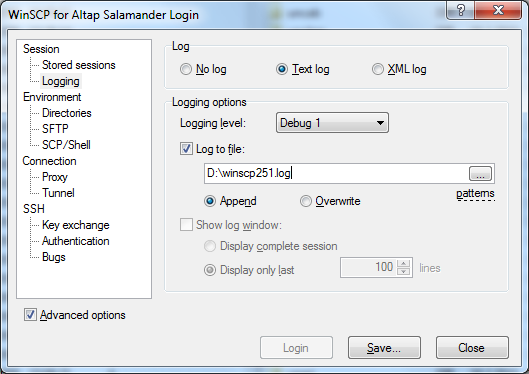

Re: error sftp on altap 2.52
Please setup both WinSCP to create log files:
