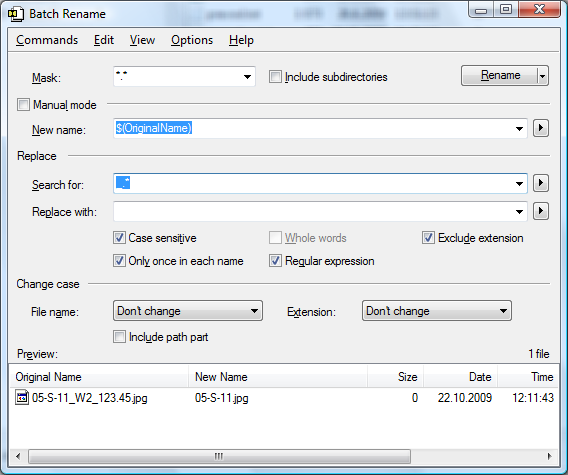

Search for "_.*". Select: Regular expression + Exclude extension.
- Clipbrd1.png (39.71 KiB) Viewed 11158 times
