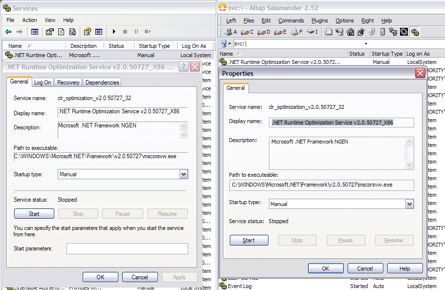

Mike, there are differences in Properties dialog, did you build it yourself? (looks like a lot of work...)

Unfortunatly there is no easy way to invoke a mmc snap-in dialog without diving deep into COM. :(
I thought it would be easier/faster to build one on my own even it lacks a few (not so often used) features in the first.

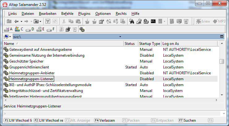

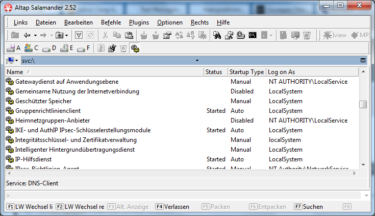

Under Windows 7 Ultimate RTM (German) there is one service that is listed only when Salamander is run as admin. It is called "Heimnetzgruppen-Listener" ("Homegroup Listener" I guess in English), part of the new Homegroup feature of Windows 7.

@th.:
Thanks for reporting - i will look into this.
Does anybody has seen this on Vista also?
