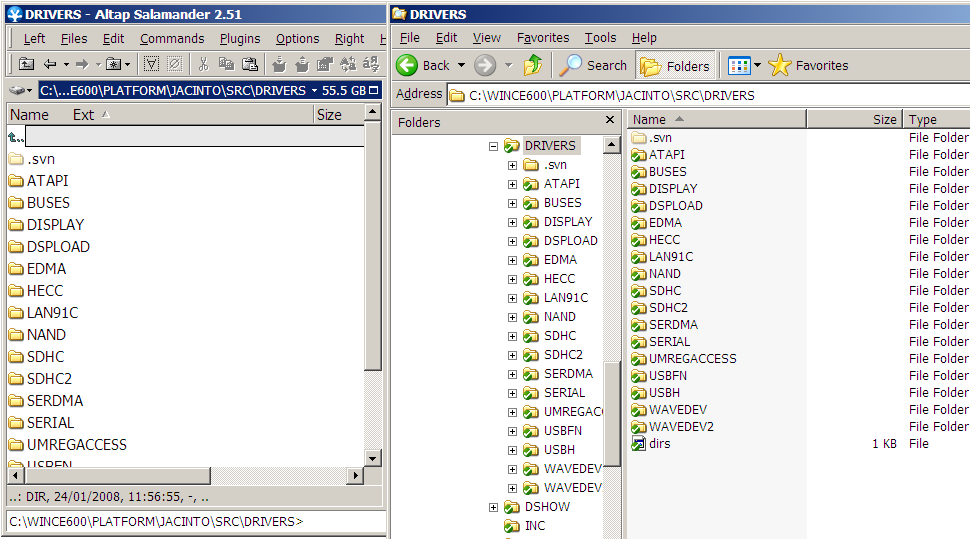

Post by voidcoder »
Sure, here is the screenshot. Strange though, the icons sometimes appear
back when re-opening SA.

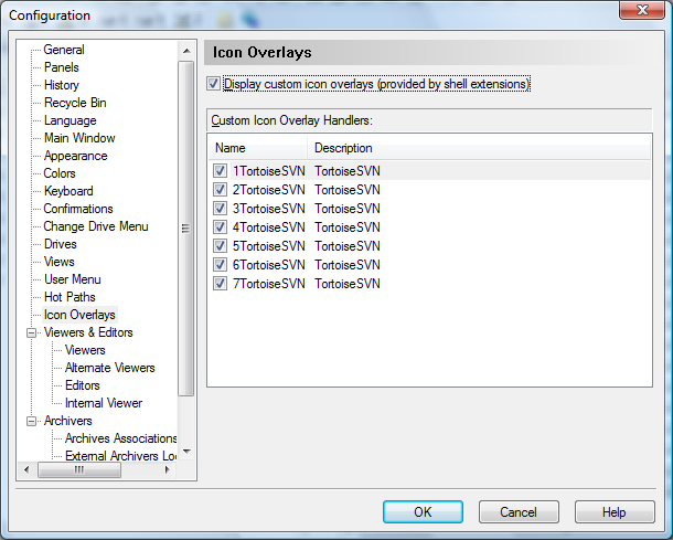

Please check also your Salamander configuration, see first attached screenshot. These options must be turned on.

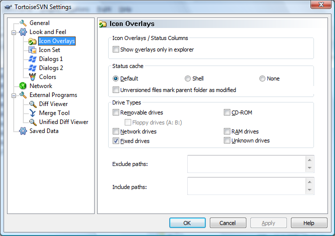

Also check the Tortoise SVN settings (the second screenshot), the "Show overlays only in explorer" must be turned off.

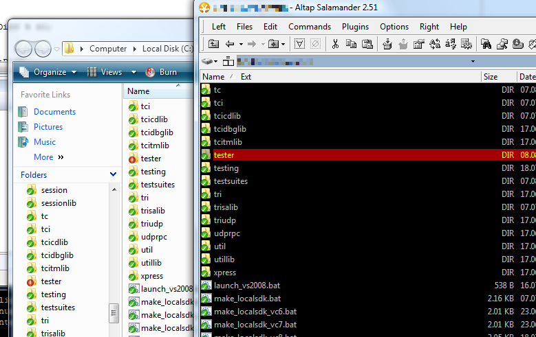

I did some tests on this and it seems to be related to how TortoiseSVN updates the overlays. If you edit a file outside Salamander (eg. in an IDE) and then browse the folders in Salamander, the icon overlay won't update to "modified". When you open the folder in explorer the file changes to modified immediately in explorer, but not in Salamander (see attached screenshot). After you've browsed to the folder in explorer and seen the updated icon there, pressing ctrl-R in Salamander causes the overlay to update to "modified" state.
I also noticed theres a small delay when browsing in explorer before the overlays appear (eg. when scrolling down). I'm guess TSVN is updating the overlays on the fly with some kind of hook, and for some reason Salamander is not firing those hooks, and hence no updates. Unfortunately I don't have time now to browse the TortoiseSVN source code to look at how TortoiseSVN hooks into explorer right now.
