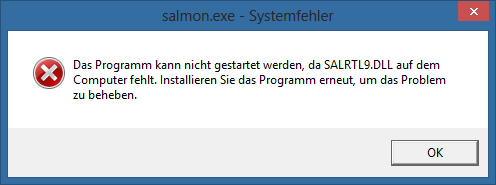

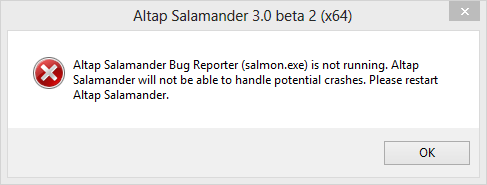

Since today I get error message when I start AS30b2 (x64).
First from salmon.exe: Missing SALRTL9.DLL, then that salmon.exe can't run without the DLL.
Not sure what had changed since yesterday, but after reinstalling still the same error.
And the DLL is there.
Thanks
Thanks

Looks like some system problem outside of Salamander. The runtime library SALRTL9.DLL is part of Salamander package.
Could you please post screenshot of the message box with error?
You can also try to inspect salamand.exe with http://www.dependencywalker.com/ - maybe you can find some details regarding this problem.
Re: Error in Win8
The two dialogs.
And it seems, he couldn't load IESHIMS.DLL. It's part of Internet Explorer.

- 26-06-2013 15-35-16.png (10.1 KiB) Viewed 50001 times
- 26-06-2013 15-33-21.png (9.34 KiB) Viewed 50001 times
