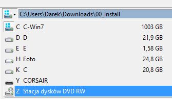

I map network drive in Windows 8:
Mapped drive
Mapped drive
but this drive (V:) not appears in AS drive list:
Drive list

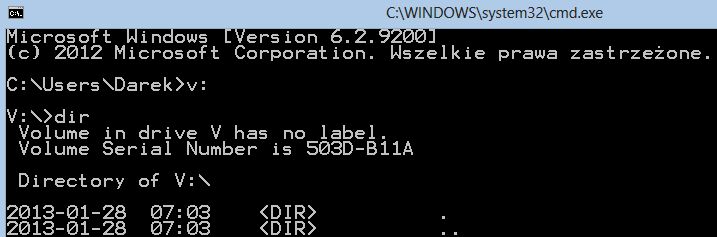

but shell see:
shell - cd OK

AS 3.0 B1 32-bits running on W8 64-bits.
