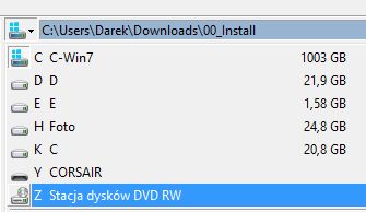

but this drive (V:) not appears in AS drive list:
Drive list
Drive list

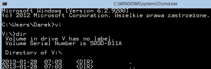

but shell see:
shell - cd OK
shell - cd OK
AS 3.0 B1 32-bits running on W8 64-bits.
