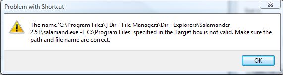

Still not working.
1. Checked configuration - it was set to save on exit
2. Checked path in properties of the launch icon. Nothing set there
3. Restarted with C:\Program Files in the left panel and D:\ in the right panel. Still opens in the same (unwanted) paths as before
4. Changed the properties in the "Target" field to - "C:\Program Files\] Dir - File Managers\Dir - Explorers\Salamander 2.53\salamand.exe -L C:\Program Files". Comes up with an error message when I save;
Any advice appreciated.
Regards - Jadag
Re: Changing the default folders in each panel
Posted: 04 Jul 2012, 10:22
by Ether
You have to enclose paths with spaces inside in double-quotes, like this:
"C:\Program Files\] Dir - File Managers\Dir - Explorers\Salamander 2.53\salamand.exe" -L "C:\Program Files"

Thank you Ether!
I went to the icon\Properties\Target and changed the path as you suggested to;
"C:\Program Files\] Dir - File Managers\Dir - Explorers\Salamander 2.53\salamand.exe" -L "C:\Program Files" -R "D:\"
Now each panel opens in the specified directory every time.
