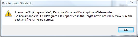

4. Changed the properties in the "Target" field to - "C:\Program Files\] Dir - File Managers\Dir - Explorers\Salamander 2.53\salamand.exe -L C:\Program Files". Comes up with an error message when I save;
Any advice appreciated.
Regards - Jadag
If you know you're going to lose - lose quickly!
Re: Changing the default folders in each panel
You have to enclose paths with spaces inside in double-quotes, like this:
"C:\Program Files\] Dir - File Managers\Dir - Explorers\Salamander 2.53\salamand.exe" -L "C:\Program Files"
