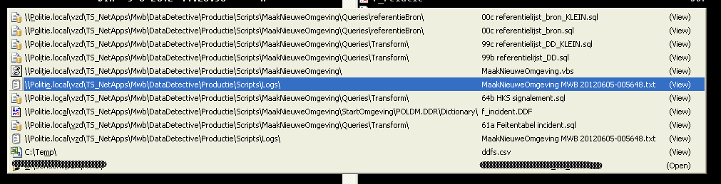

Look:
Proof!
Proof!
Notice that the entry for viewing MaakNieuweOmgeving MWB 20120605-005648.txt (in \\Politie.local\vzd\TS_NetApps\Mwb\DataDetective\Productie\Scripts\Logs\) is in there twice.
How did this happen :?:
The contents of the (log) file did change over time. Can that be the reason?
Shouldn't Salamander de-duplicate the list?
This is Salamander 2.54.

It turns out I can! :idea:
Try this:
  • have some file called xyz.txt
  • view it using F3, close it
  • view it using Alt+F3, close it
  • check the recently opened files list (Alt+F11)
The contents don't need to change, only the way to start the viewer should differ. Even though both ways use the Internal Viewer.
Viewing the file in (for instance) the database viewer via Ctrl+Shift+F3 adds yet another entry. But that's ok I guess.
