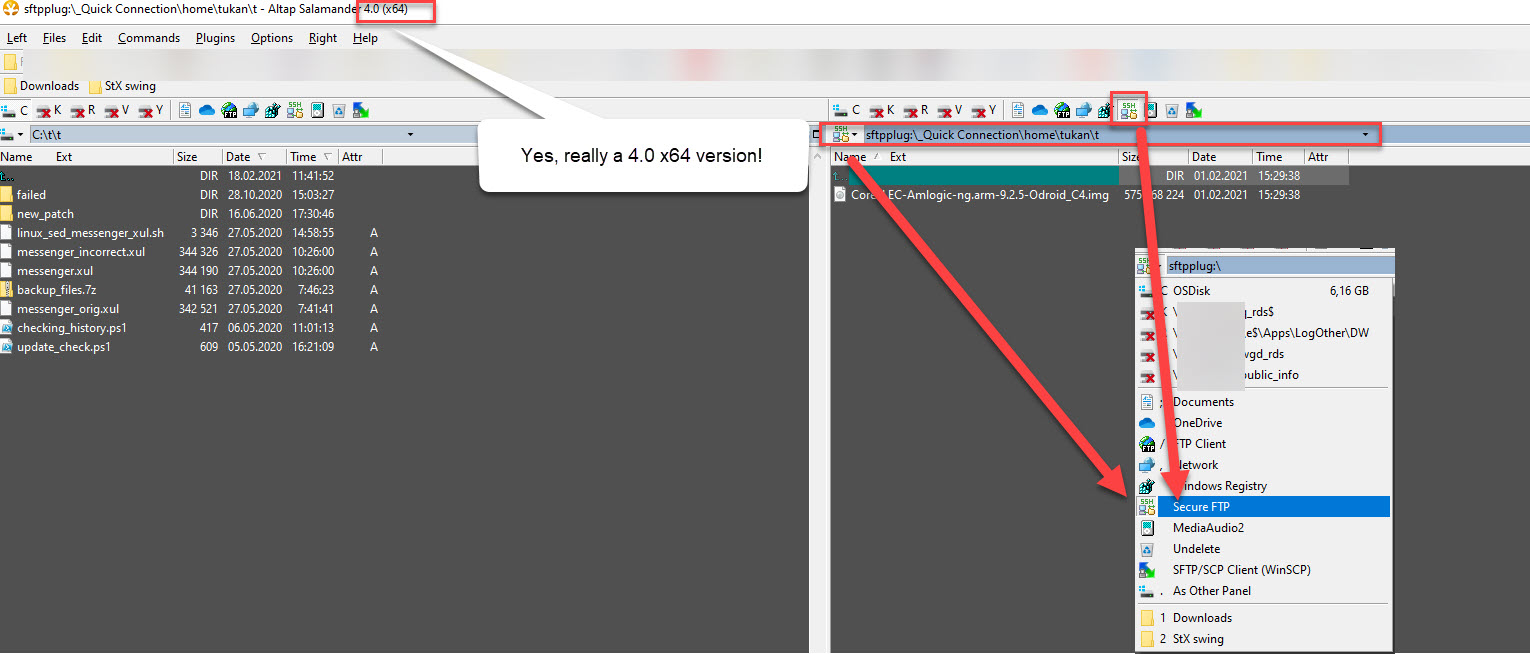

I'll add to the latest tips series a dearly missed WinSCP replacement. Not kidding and it really works!

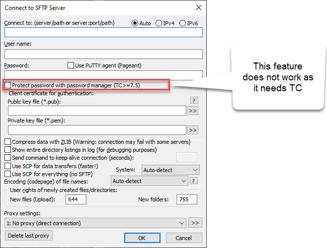

As you probably know WinSCP plugin is not available for the AS x64. We can save the day again with the Manison's proxy plugin. It works as a charm and enables you to connect to any sftp server you need. Currently the only feature that does not work, that I know of, is the check box Protect With Password Manager (TC>=7.5).
Prerequisites: You need to follow the instructions of TC proxy plugin to register the plugin.
How does the sftp plugin work? Actually quite great!
Here is how it looks like connected via sftp and showing a file:
This is how the sftp plugin connection dialog looks like:

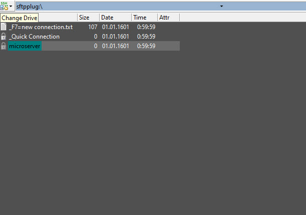

You can store the session which will be then at the list:
