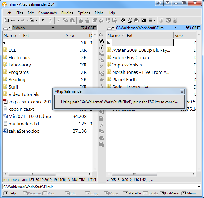

Lately I'm having a strange error that is a little annoying... lots of times I have to close and reopen AS.
Anyway on some occasions the "Listing path" popup windows shows and there is no way to close it.
Now panel already got the new list in it, but the window is still there.You can also press the x button,
but the windows still wouldn't close.
So close/reopen gets it.

- popup.png (78.19 KiB) Viewed 23862 times

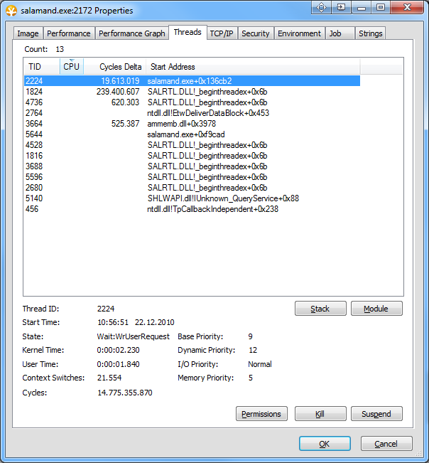

You should look at the frozen instance with Process Explorer (or Process Monitor) and inspect the thread stacks. You should be able to see what is causing the freezes.Waldemar wrote:Do you want that I make some other tests?
Re: Pop up window doesn't close
Hmm... that ammemb.dll is suspecious... it's part of the Actual Mulitiple Monitors program.... that could definitely influence the windows.... will uninstall and we'll see.
I found a link - maybe it'll be helpful: AMM 3.0 Freezes World of WarcraftWaldemar wrote:it's part of the Actual Mulitiple Monitors program.... that could definitely influence the windows....
Yep it's AMM... as soon as I've installed the AMM back on the popup stayed on the screen.
