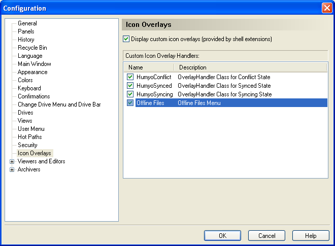

wguggen, please stop the Humyo service, start Altap Salamander and show us screenshot of the following window (Options > Configuration > Icon Overlays):

I have updated the humyo client and install a new subversion client called smartSVN (http://www.syntevo.com/smartsvn/index.html).
I saw some smartSVN entries in the custom icon handler window.

Do you have another overlay icon handlers installed besides Humyo and smartSVN?
Could you show us the mentioned dialog box?
