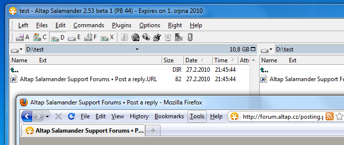

Hello,
I meet this problem too. I see that it wasn't solved...
Could be this thread renewed?
Re:
Posted: 27 Feb 2010, 21:27
by viktorka
Jan Rysavy wrote:What URL are you dragging to Salamander? URL to some local file or to web page? Are you pasting it into the panel or to the Directory Line?
Its URL from addressbar in firefox (now 3.6, but also in earlier versions). it is (e.g.) address to web page. when I drag it and move over Salamander (file pane), an icon with "shortcut" appears, but by releasing nothing happens.
Usually (in explorer or TC) the shortcut is created after drag&drop.

Re: URL shortcut is not created when d&d from Firefox
Posted: 01 Mar 2010, 19:51
by therube
I'll confirm this.
Both with SeaMonkey 2.0.3 & FF3.5.3.
The URL link/shortcut is created in Salamander, but the browser then quits (crashes).
Here is the crash report, http://crash-stats.mozilla.com/report/i ... 2532100301.
Ooops. Made an edit above, s/FF3.6/FF3.5.3/.
FF2.0 did not crash.
(Not in a position to test FF3.6 at the moment.)
FF3.6 does create the link & does not crash.
SeaMonkey 2.0.x & FF3.5.x are both in the same "Gecko" family, 1.9.1.
FF3.6 is Gecko 1.9.2 & FF2.0 is Gecko 1.8.1. FF3.0 is Gecko 1.9.0.
FF3.0 does create the link & does not crash.
