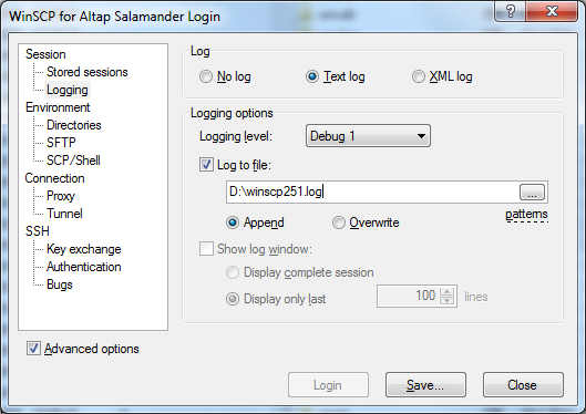

Please setup both WinSCP to create log files:
Re: error sftp on altap 2.52
Posted: 18 Feb 2010, 22:36
by jpermana
Thanks Jan,
Attached log collected from altap 2.51 and altap 2.52.
