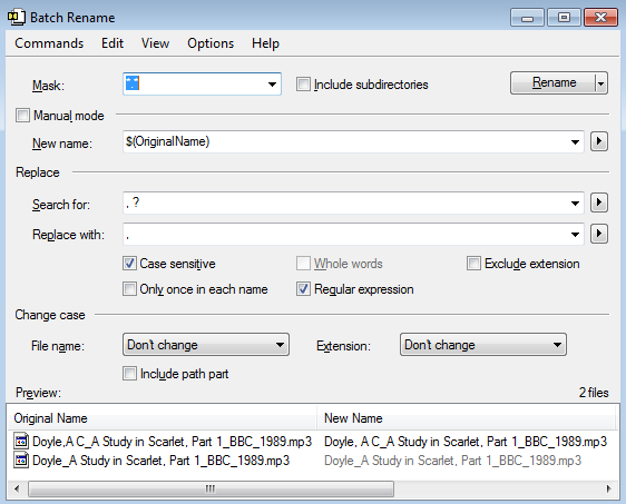

Is there a way to use the Rename function in the following way?
I want to do a pretty easy search and replace action (replace "colon" with "colon and space").
So far no problems.
Example:
[OLD FILENAME]
Doyle,A C_A Study in Scarlet, Part 1_BBC_1989.mp3
[OLD FILENAME]
Doyle, A C_A Study in Scarlet, Part 1_BBC_1989.mp3
Now here's the hard part: I wish to limit this action to the file name segment before the first underscore.
I need to avoid the following scenario (where 2 spaces are created if the author's name does not include a colon):
In this case, even the option "Only once in each name" does not help.
[OLD FILENAME]
Doyle_A Study in Scarlet, Part 1_BBC_1989.mp3
[OLD FILENAME]
Can I set an underscore as an end point for a S&R operation?
Thanks for any help
Tim
Re: Rename function - experts needed
Tim wrote:Can I set an underscore as an end point for a S&R operation?
Yes, you can do that, but I think it would suffice to create a regexp that wouldn't add a space when there already is one. Use:
Search for: , ? (comma, space, question mark)
Replace with: , (comma, space)
[ ] Only once in each name
[x] Regular expression

Efharisto, ether!
Mind-boggling.
Your approach is much smoother.
I really should study regexp's!
Once again, thank you very much indeed.
