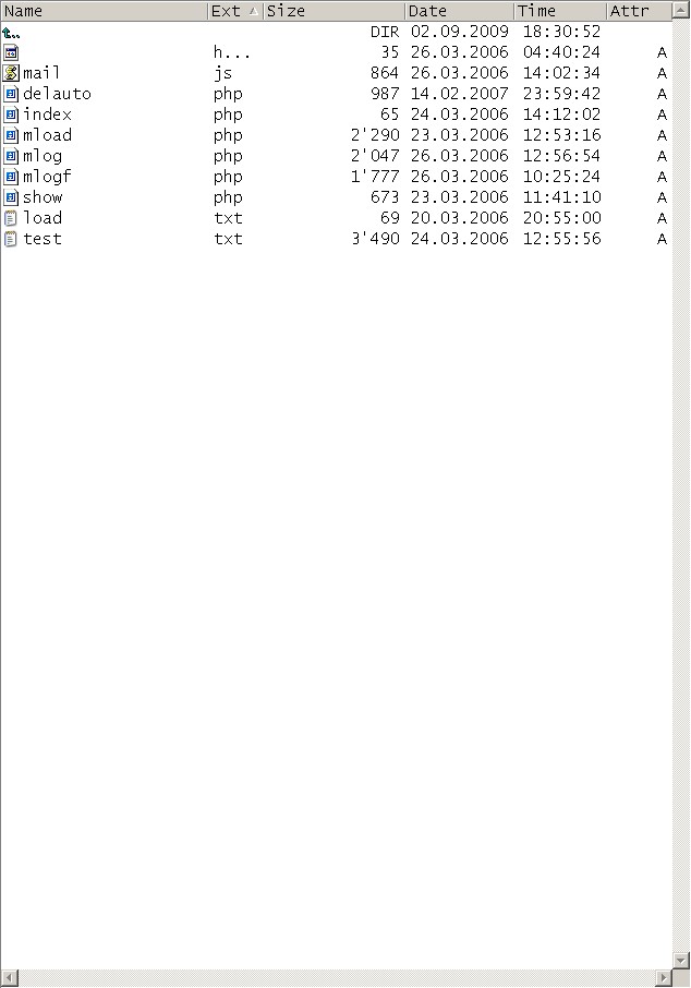

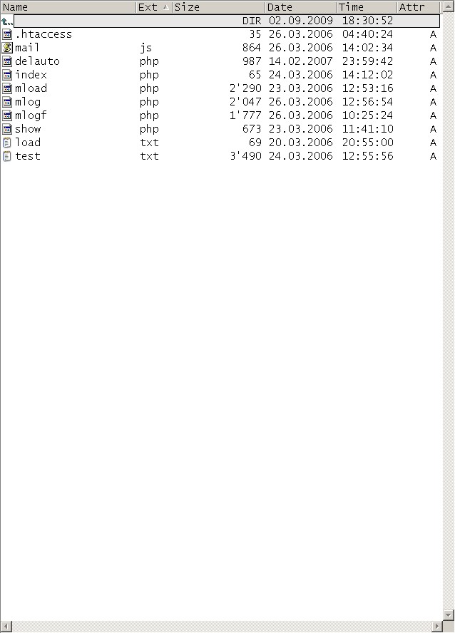

Hello Jan,
i have a problem with the version 2.52, the listing of the files heading with a "." is very difficult to read now (screenshot11). the version 2.51 takes the filename ".htaccess" as "name" (screenshot12) and that was much better ...
i have a lot of such files ...
best regards
J. Agam

Klettermaxe wrote:No problem at all here with Salamander 2.52 final.
You have to enable the Separated Extension column in Options > Configuration > Views to see this problem.

Re: files heading with a "." in 2.52
I have fixed this. All names containing only one dot at the beginning are shown in Name column instead of Ext column. It will be available in 2.53 (also in its preview build).
