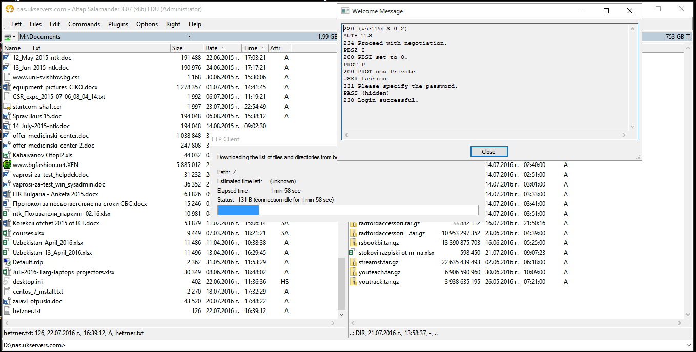

Hello,
I have just installed a new server with Centos 7.2 and vsftpd server on it.
The ftp plugin of Salamander works OK with this ftp server, until I have enabled SSL in vsftpd and especially option force_local_data_ssl=YES
The problem I see is that it can't list directory tree when data channel encryption is on.
In the same time it works OK when only control connection is encrypted. So when only control connection is encrypted - from the vsftp side with option force_local_logins_ssl=YES Salamander works OK, but when data connection is encrypted it does not list directory.
I have tested my ftp server with filezilla and no problem observed.
I do not have doubts that the problem is in the server part (vsftpd) as I have another one identical ftp servers and my configuration is from https://access.redhat.com/solutions/3436.
Could someone test with similar configuration SSL enabled Vsftpd ftp server and latest Salamander 3.0.7. Can you reproduce the problem?
regards
Nikolay Kabaivanov
FTP plugin do not work with SSL Encrypted Data connection
- screenshot from ftp connection with SSL enabled (control and data channel encrypted) ftp server
- 1.jpg (320.47 KiB) Viewed 26269 times
