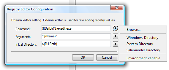

It will be supported from Altap Salamander 2.52 beta 2. Thank you for this idea!
Little off topic: There are other places where the possibility of using environment variables was requested (Hot Paths, Change Directory, Copy, Move, ...). Will it be implemented there, too?
Environment variable in Plugins configuration
Maybe we will find the time someday.
This was relatively small patch (Registry Editor and Renamer plugins only) and I only synchronized their configuration dialog boxes with existing (User Menu) in Salamander for better portability.
