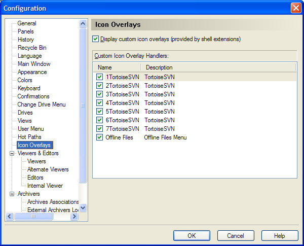

From Altap Salamander 2.51 it will be possible to disable particular icon overlay handlers (provided by shell extensions).
Disable/Enable icon overlay handlers
