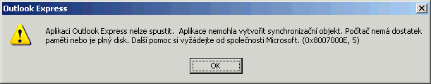

Now, I want to post my experience with similar issue:
1] shell and OE are running as ether
2] AS is running in two instances, once as Admin, once as ether
3] Ctrl-E in the ether one is working fine
4] Ctrl-E in the Admin one is not working, popping up some error (attached)
5] after ending OE, Ctrl-E in Admin works fine and shows a new mail window
6] with the new Admin's OE still there, Ctrl-E in ether's AS refuses to work with the same error as before
7] it's all funny; I will probably end up using Debian or Fedora Core :wink:
BTW how does the 'xxx wrote' feature work? I couldn't find anything more than the Quote button, which has different effect.
an error...
an error...
