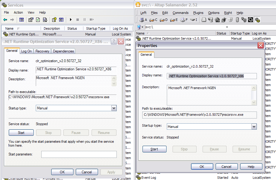

Mike, there are differences in Properties dialog, did you build it yourself? (looks like a lot of work...)
Could you please also make the Properties menu item bold as default item?
Re: Service Explorer Plugin
Posted: 08 Sep 2009, 18:30
by Mike12345
Unfortunatly there is no easy way to invoke a mmc snap-in dialog without diving deep into COM. :(
I thought it would be easier/faster to build one on my own even it lacks a few (not so often used) features in the first.
The context menu is updated - download the new version from the first post.
Thanks for your feedback. :wink:

1st thanks for this plugin, I have started using it every day.
As you wrote your own "Properties" dlg and not using the system one, it could not be a big problem for you to change the first item "Service name" to be also selectable and copyable (Ctrl+C) as the later ones (DisplayName and Description). What do you think?
I often need this name to do some stuff on cmdline after, i.e. "sc delete 'servicename'" and unfortunately authors of services tend to give them long obscure hard-to-remember names. So the Ctrl+C posibility could be handy.

some small glitches:
-the TAB-order in your properties dialog box is weird
-there are not hot keys assigned to labels such as "Display name", "Description", etc
-what about the Help button, does it have any sense?
-typo in "Path to executable:" label
-small spacing above the "Path to executable:" label

@xm:
Shouldn't be a problem. Do you have need of the new "Delete Service" Feature also? :mrgreen:
New version is up - download it from first post.
Version 0.0.8 (08.09.2009)
+ new "delete service" function (use with caution!)
* changed tab order
* Servicename is now selectable

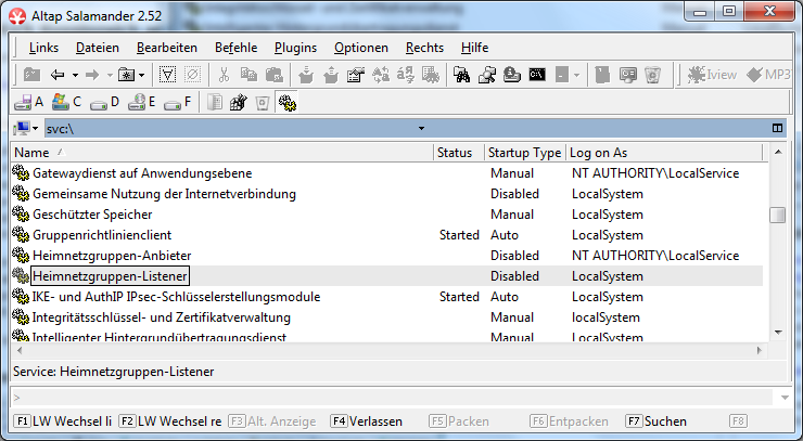

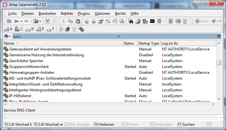

Under Windows 7 Ultimate RTM (German) there is one service that is listed only when Salamander is run as admin. It is called "Heimnetzgruppen-Listener" ("Homegroup Listener" I guess in English), part of the new Homegroup feature of Windows 7.

@th.:
Thanks for reporting - i will look into this.
Does anybody has seen this on Vista also?
