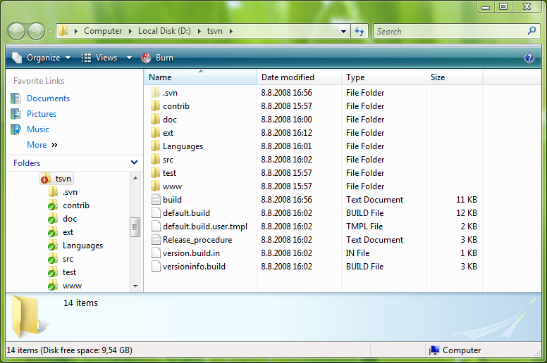

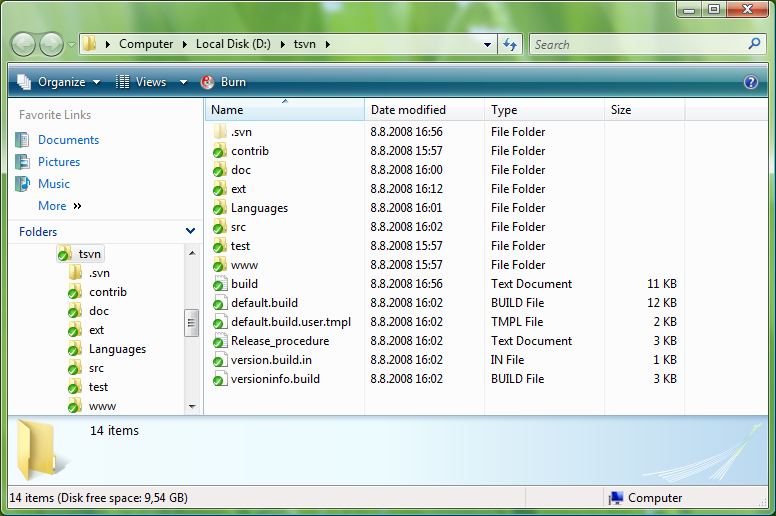

We are able to reproduce this problem, even in Windows Explorer. Please look at attached screenshots. Windows Vista Ultimate x64 EN.
TortoiseSVN 1.5.2, Build 13595 - 64 Bit , 2008/07/31 17:04:57.
How to reproduce it: change build.txt using text editor. Right click it and from the TSVN menu choose the Revert command. (tsvn1.png)
Two dialog boxes will be displayed. To reproduce the problem you must click the OK of the second window FAST (as soon as possible). Explorer window will be displayed without overlay icons. (tsvn2.png)
After a few second is Explorer refreshed. (tsvn3.png)
Could somebody please test this scenario on your Windows? The phase without overlay icons looks very suspicious to me.

- tsvn3.png (113.92 KiB) Viewed 22266 times
- tsvn2.png (112.59 KiB) Viewed 22266 times
- tsvn1.png (244.85 KiB) Viewed 22266 times
