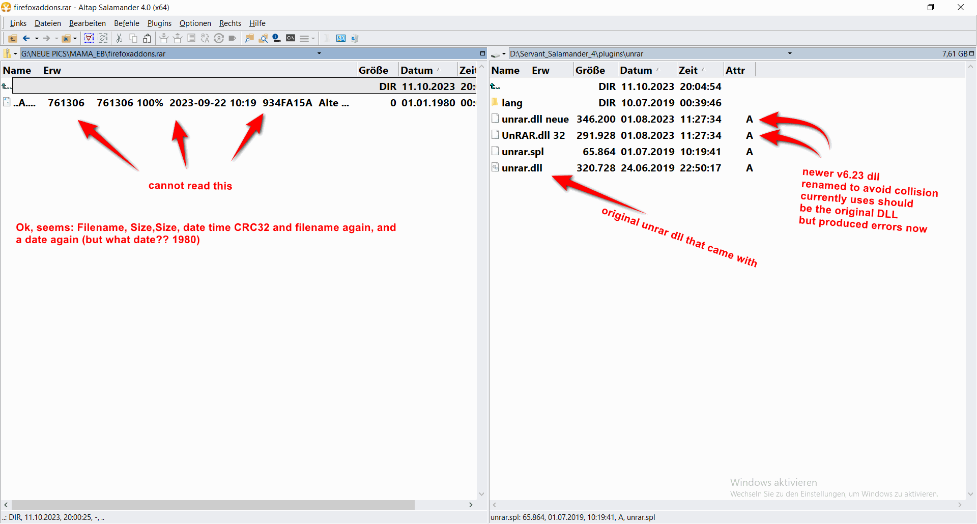

hm, well I tried to copy current unrar.dll from RAR-homepage into the /plugin/unrar-directory.
I have installed Salamander 64 bit, so I copied the 64 bit unrar.dll beneath the unrar.spl.

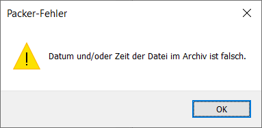

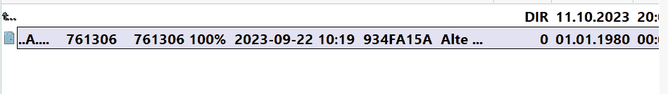

But everytime I broswe into a rar file, I get two kinds of errors:
one, which regularly appears, is that filenames and dates a shown as "kyrillic" like long strings,
or sometimes occurs: Packer Fehler (means "Packer Error")
Datum und/ oder Zeit der Datei im Archiv sind falsch (means: "Date or time of the files in the file archive are wrong")
later: Also renaming back the old hidden unrar.dll that came with and removing the newer dlls and starting Salamander a second time, does not work now anymore. WTF?! (OK, every without browsing rar files seems to work)
how can it be, that when I restore all° - I cannot now still can't browse rar files with old unrar.dll in directory, too ???
°= (restored situation is shown in big screenshot blow)
What did you do as workaround to brows rar files as usual?
Why does Total Commander does not have problems with this?? (and why/how he supports TABs ??? [in 2023 ....] :D)

SelfMan wrote: 11 Oct 2023, 23:57 I don't know whet you did exactly, but it's working for me just fine.
I just downloaded the new DLL (64bit) from RAR Homepage and copied it into the special plugin directory and started Salamander. But browsing RAR files does not show the contend as usual. (see screenshots above)
Then I also download the free Salander 4.0 (64bit) again from here,
deleted the registry values (Altap), renamed the folder,
installed Salamander again
copied the unrar.dll (64bit) into the plugin directory and overwrote the old one.
Started Salamander - and - the same ...
I have no idea, what could be gone wrong?
