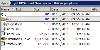

If I first unpack slister.zip & put its contents into /plugins/slister/, followed by unpacking tcproxy_as30.zip & putting its contents into same, once I go to Plugins Manager & select tcproxy.spl, I am not asked to "browse for a" lister (wlx)?
If I first unpack tcproxy_as30.zip, putting its contents into /plugins/slister/, but do not unpack slister.zip, then I am prompted for the wlx (or zip as it is) & Plugins Manager unzips the zip placing its contents into same.

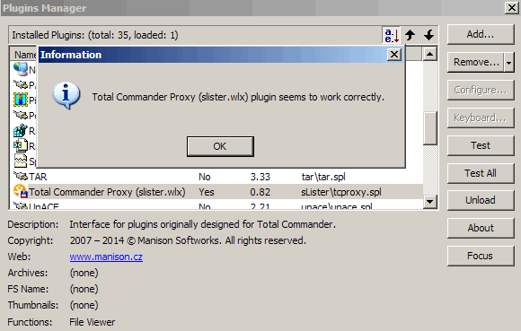

Test shows, OK.

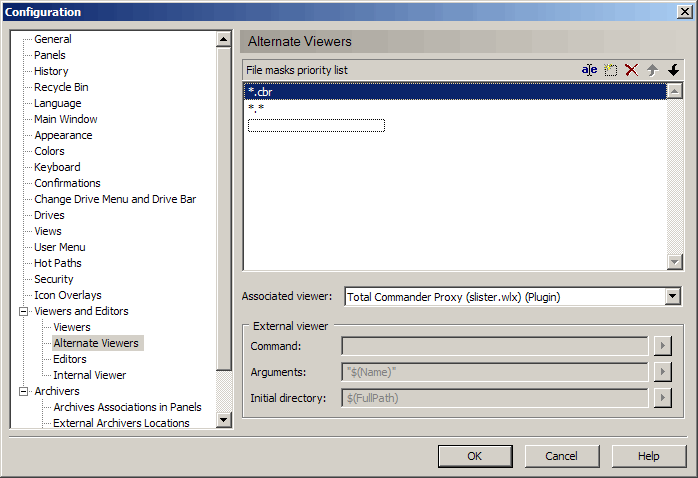

Viewer Configuration, as a test, I set *.cbr (not a file type I've used before) to Total Commander Proxy (slister.wlx).
I take an existing .pdf, rename it to .pdf.cbr, hit F3 to view it & its opened in Internal Viewer instead of sLister (aka Sumatra).
sLister directory.png (6.53 KiB) Viewed 86289 times
sLister Plugin Test.png (12.08 KiB) Viewed 86289 times
sLister Viewer Config.png (11.8 KiB) Viewed 86289 times

therube, you have added SLister to 'alternative viewers' so you have to press Alt-F3, and not just F3 :D
I have tried what you did with *.cbr and a PDF file (but in basic 'Viewers') - everything works fine for me with F3.
I knew there had to be a Duh! moment in there.
