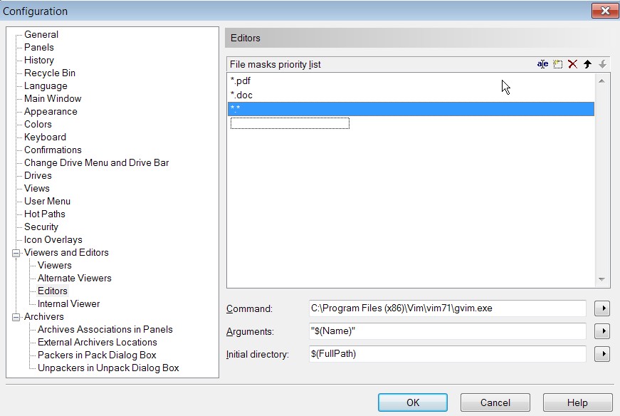

Then it must be some software/tool which you've installed on both computers.
Still check "Options > Configuration > Viewers and editors > Editors" and post a screenshot.

This looks as usually. Some external program has stolen F4, so the question is if Salamander can get it back. I will try to reinstall it.
