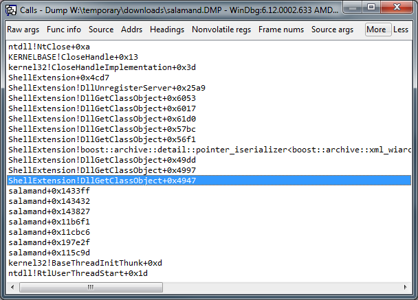

I noticed some potentially problematic modules: Acronis tishell64.dll, SafeCopy ShellExtension.dll. I see also AppPatch modules (AcGenral.dll, AcLayers.dll, AcXtrnal.dll), which is weird.
Judging from the call stack, Salamander seems to be stuck in the ShellExtension module, so I'd try disabling that one first. Note that ShExView doesn't indicate very clearly if you're looking at 64-bit or 32-bit extensions. If you have time, you could try completely uninstalling SafeCopy (don't forget to restart and double-check it's gone using ShExView) to see if that helps.
