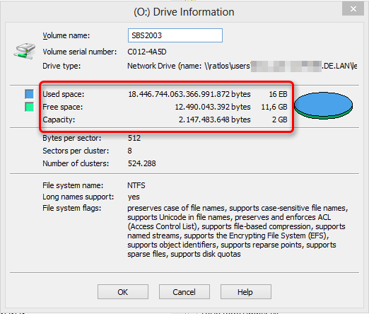

Second, the two little bugs:
a) STRG+1 shows infos of a drive, including the size. If I do so on an network share, i got 16 Exabytes of used space, see screenie. In v2.5 it was correct. The share is on an SBS 2003 with 2GB quota, Testsystem: Win8 Pro x86 and Win7 Prof. x64.

Thanks!
I'll look at problem with incorrectly reported used space. I have found it already on my to-do list.

Re: Beta 3 - two little bugs
Fixed. It will be available in beta 3 which will be release this month.
