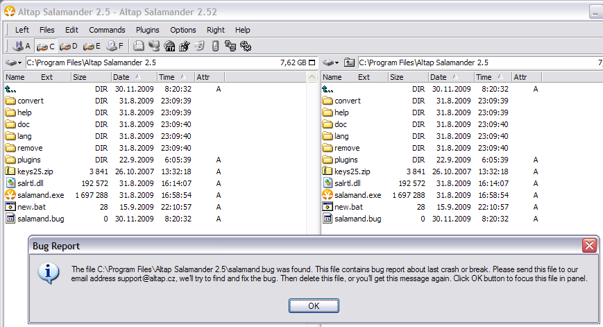

Bug report information is displayed until you delete generated salamand.bug file in AS home directory. See the attached screenshot.
