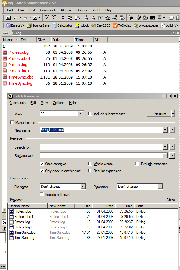

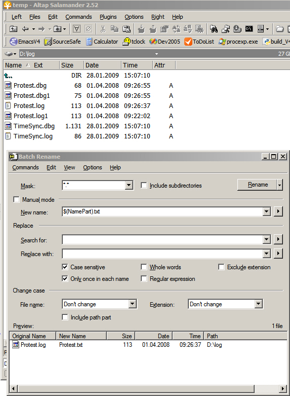

BTB my "Problem"
unselected
unselected
and the "Solution"
files selected :)
files selected :)
Thanks again, cheers
