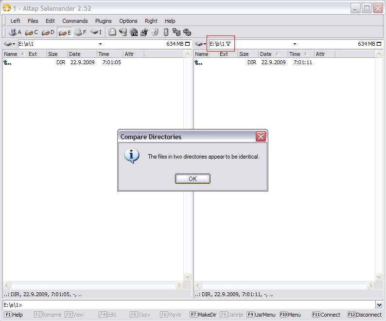

One idea: please check Altap Salamander options: menu Options > Configuration > Panels, the Hide files and directories with hidden or system attribute.
Is this option clear or checked on your computer? I can reproduce described error when on of subdirectories contains hidden file that is filtered by this option.
Please see the attached screenshot, there would be filter symbol, as you can see in the right panel.
