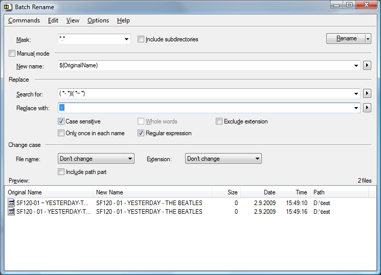

Re: Dash and Space
Select all names and use the Plugins > Renamer > Batch Rename command with following settings:
Search for: "( *- *)|( *– *)" (without quotes)
Replace with: " - " (without quotes)
Turn on the Regular expression option.
Turn off the Only once in each name option.
Note: this will simply replace ALL dash characters (and surrounding spaces) with " - ".
So watch your files, there could be another dashes (for example in album name) you do not want to replace.
Note2: you have two different dash characters in your names, therefore the more complicated search for: "( *- *)|( *– *)"
