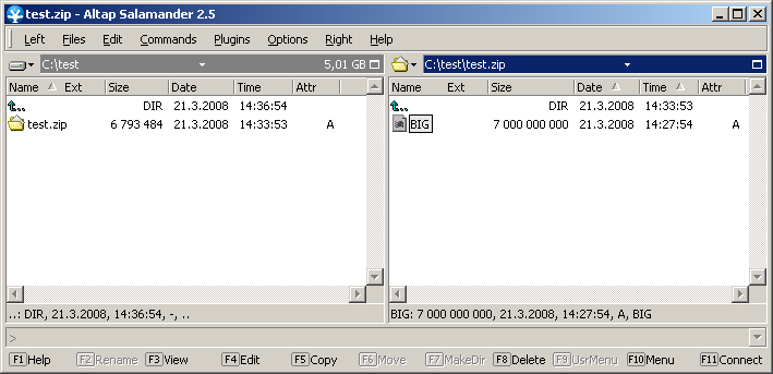

AS 2.5 displays wrong filesizes for large files contained in a ZIP-File. Today I've receivd a 950 MB ZIP-File that contained > 6 GB file. AS 2.5 reported a filesize (file within the ZIP-Archive) of 320 MB. Seems to me the ZIP-Plugin uses 32 bit datatype for the filesize....
Bye,
Michael
Hi Michael, Salamander 2.5x does support ZIP archives with files > 4GB, please look at attached screenshot. Do you have idea how your archive was created? Could you please show us screenshot from Salamander and WinZIP?
Btw, large file could be created using "fsutil file createnew BIG 7000000000" system command.
Guest
Post by Guest »
Jan Rysavy wrote:Hi Michael, Salamander 2.5x does support ZIP archives with files > 4GB, please look at attached screenshot. Do you have idea how your archive was created? Could you please show us screenshot from Salamander and WinZIP?
Jan, sorry for the long delay - I've been on holidays...
I could imagine that the ZIP-File was created using ZIP from http://www.info-zip.org/ (because the client sent us an UNZIP from http://www.info-zip.org/).
I can't sent you a WinZIP screenshot because I've no WinZIP license (guess which Tool I use to uncompress ZIPs - it starts with "A" and ends with "ltap Salamander" ;-) )
So I would suggest that we stop this here... Seems to me that we have a somehow "strange" ZIP-File here.
BTW, "UNZIP -l myzipfile.zip" also shows me "only" 320.359.936 Bytes...
Thanks for your support,
Michael
