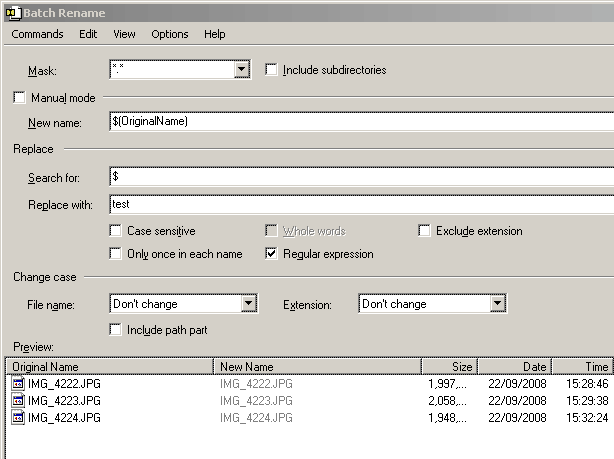

I am trying to use Batch Rename with Regular Expressions and want to match the end of a name but it seems that this does not work in Salamander 2.51.

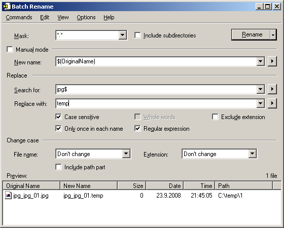

Hi, as Jiri wrote the dolar sign means end of line. It specify the position - in your example you are missing what you want to search for, you have only specified the "at the end".
Usage example:
Lets say you have filename jpg_jpg_01.jpg and you wan to rename the last occurance of "jpg". In this case you must search for expresion: jpg$

I just wanted to append something at the end of each filename.
From what you wrote the solution for this would be to capture the last character in a group:
and consider this in the replacement expression:
$(0)test
