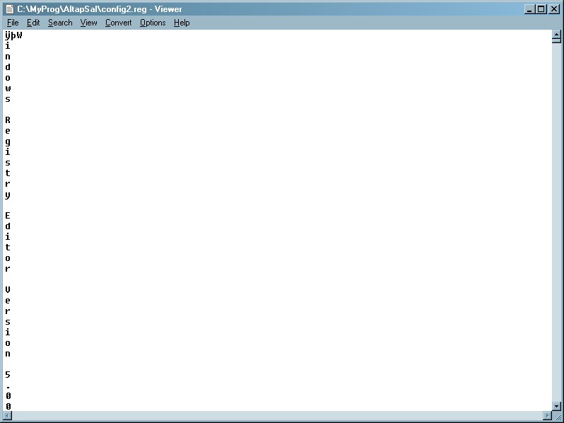

Viewing a "Windows Registry Editor Version 5.00" .reg-file in the internal viewer looks very strange (see attachment). Everything is okay with "REGEDIT4" .reg-file which is the format altap salamander exports its own registry.
A bug?

Hawkwind wrote:A bug?
No.
Unicode and Configuration - Internal Viewer - Line Ends - NULL checked.
.reg v. 5.0 is unicode formated (two bytes per char) and second byte is usually zero, which by-default breaks line in internal viewer.
We plan to support Unicode in Salamander 3.0, please look at roadmap.

I have also run into the unicode problem with the internal viewer. I'm running AS 2.5 and I still see the vertical view as shown in the above screenshot. I checked my configuration and I have NULL (and all the others) checked. What else do I need to do?

dprice wrote: ... I checked my configuration and I have NULL checked. ...
Uncheck it.
There will be 'ugly' characters (after each normal), but no vertical view
