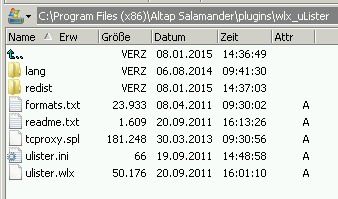

Well, for me it actually looks like this:
And this is a working installation on Win7 x64 with AS 2.54 (x86).
The redist folder is directly copied over from the downloaded .zip, so it contains the actual files, no more subfolders.
If it did not work for you this way, there might have been an access problem. But I'm glad you figured out a way to make it work for you.

Yes, I also have the \redist folder (and not its contents) in the plugin directory with tcproxy.spl and ulister.wlx64.
It is strange that it did not work the default way.

You are right. I removed the contents of \redist and recopied the folder itself.
Don't know why it didn't work in the first place, but now it did.
Thanks again.
