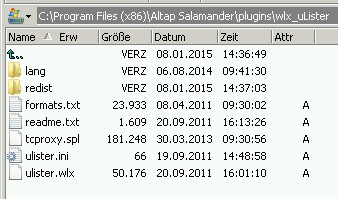

Well, for me it actually looks like this:
And this is a working installation on Win7 x64 with AS 2.54 (x86).
The redist folder is directly copied over from the downloaded .zip, so it contains the actual files, no more subfolders.
If it did not work for you this way, there might have been an access problem. But I'm glad you figured out a way to make it work for you.
