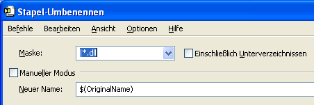

I was irritated by a strange entry (|*.dll) in the "Batch Renaming" mask. Today I found the solution, I've used "Filter" (STRG-F12) months ago.

Hi Thomas,
this only happens when the filter is active in the panel from which you launch the renamer plugin. This is exactly what I would expect to happen. Otherwise I might rename unexpected files, because I did not see them in the panel I came from, that is, the set of files I usually want to process.

Hello SvA,
I realy think that this is a fault. Because if I use a filter in a panel, I can make my file selection for "Batch Renaming" only with the active filter.
The mask in the "Batch Renaming" Plugin is for the name of the selected files. For this reason I expect the Mask: "*.*" as the default setting.

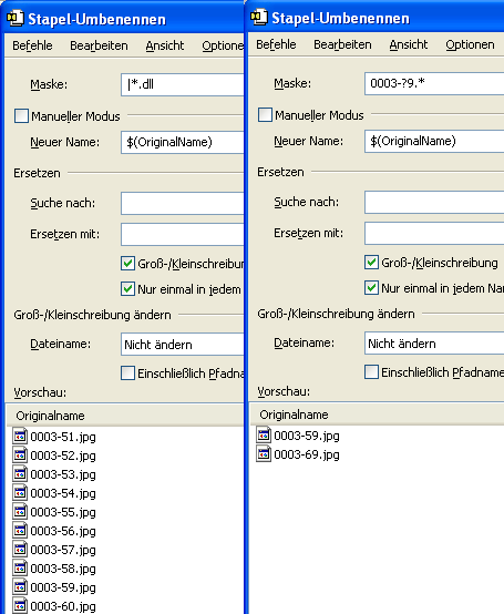

Example for the use of mask (|*.dll has no function in the mask, but it irritated extremely):

This part of help should make this thing clear:
Mask:
You can filter files for batch rename operation by this mask. It's especially important when you rename files in subdirectories (e.g. you want to rename only *.htm files).
So, mask is not important for selected (or focused) file(s) in panel, but for selected subdirectories or focused subdirectory. I think it's good that this mask is copied from panel filter because it will filter content of subdirectories to files visible in panel with that filter when you enter such subdirectory.
BTW, |*.dll means all names except *.dll.
