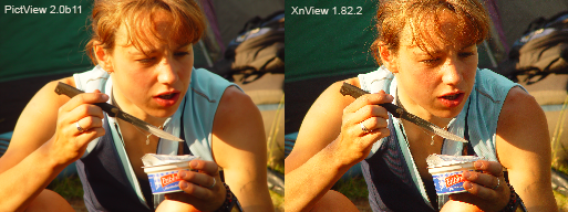

Btw: compare following two screenshots from latest versions of PictView and XnView. Is there a way how to get smooth image view in the XnView?
Yes:
Tools>Options>View>HighZoomQuality
There are three choices. You can also smooth the browser preview:
Tools>Options>Browser>Preview>Use high quality
I agree that smart image caching is the way to go!!! :)
PS: 1GB of RAM
Mouse-centric, Registered

John, could you please try to turn on High zoom quality - Reduce option and open your big PNGs (how long it will take)?

From your inquiry, my guess is that PictView automatically smooths the image when fitting to the window. I already had the XnView smoothing option "Fit to Window/Desktop" set to on for the previous "test"... that's standard for me.
After setting XnView's "reduce" to on, though, there was no perceptual change in XnView's loading behavior/speed. Of course with "reduce" on, zooming out in XnView hestitates for a couple of seconds before showing the next incremental zoomed view.
Setting the XnView high quality "enlarge" option to on, however, slows things enormously. I never use that on large images... don't really need to, either.
The on-screen quality of images presented in PictView and XnView at any zoom ratio looks identical to me.
IMHO, the best strategy for smoothing a large image is to load and display the unsmoothed image immediately, then overlay/replace the initial view with the smooth version when it is ready.
