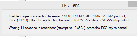

My OS is Windows 8.1 and a have never problems with ftp. But since 1 week i get after hours this message:
Error: (10093) Either the application has not called WSAStartup or WSAStartup failed
What can i do? I have only the windows firewall and anti virus program.
Re: Lose FTP-Connection after hours
We are calling WSAStartup (and result is checked) when FTP Client plugin is loading, so error message is probably without sense. We don't have any idea what can cause such problem, we are sorry.
When you close and open again Salamander, does FTP plugin work again or not?

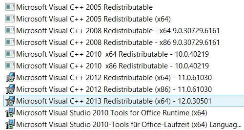

Please can you check that you have all VC++ runtimes up to date?
stefanstp
Posts: 11
Joined: 16 Mar 2015, 08:56
Post by stefanstp »
I have following updates installed:
It's ok?
Posts: 1184
Salamander loads different libraries from v8.x,9.x, and 11.x branch. What I cant see is is the 8.x version.
On my OS, Salamander also loads msvcr80.dll v8.0.50727.6195. Although I am not sure if this is related to the problem or not.
Did you try the 32 bit version of Salamander?
BTW go to http://www.ma-config.com/ and scan your system. You will be offered a list of updated drivers which you can download there and install.
