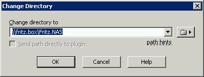

Now Salamander tries to connect:

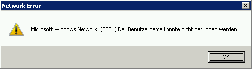

Salamander errors out: (The error reads: Username could not be found)
There never was a prompt for credentials. On clicking Ok, we're back at the Change Directory dialog.

Your questions are beside the point, in my humble opinion. The point is, I would like to get a chance to provide credentials rather that just getting a failure message, which, by the way, in typical Windows manner, does not provide any useful information. What user name cannot be found and where has the system been looking for it?
