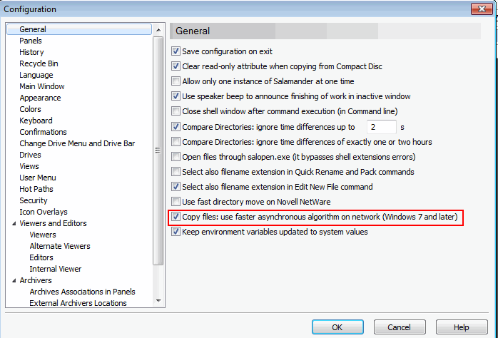

- try to switch off async alg. in Salamander -

1) mapping the different ntfs-3g discs to different drives in Salamander results in moving the directories works!
2) switching off the async copy method has no effect - does not work.

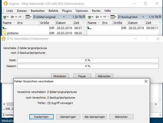

Posted: 26 Feb 2016, 09:08
by robw
Hello Jan, thanks for your reply!
As I've mentioned before it's the same behaviour today. Running Salamander 3.06 in Windows 10 as Administrator.
I have two USB-Discs with NTFS mounted in Debian Jessie. One with my picture-files, the other one as backup.
Access from Windows via Samba 4.1.17.
Copying between the two discs works very fine, equal with files and also folders.
But moving only works for files, not for folders.
Since the discs are formatted with NTFS this cannot be an issue with linux privileges - all are granted: 777!
It complains about "No Access granted" (German: "Zugriff verweigert").

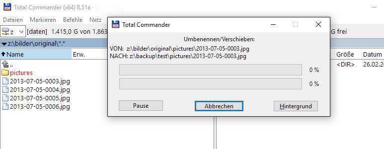

In Total Commander it works. Look:

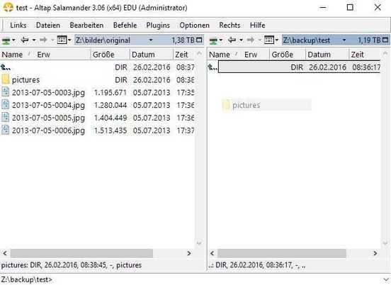

Total Commander moving
It's funny, because if the directories to move are on the same disc, it works also in salamander. But moving dirs which are on two different discs do only in Total Commander, not in Salamander.
