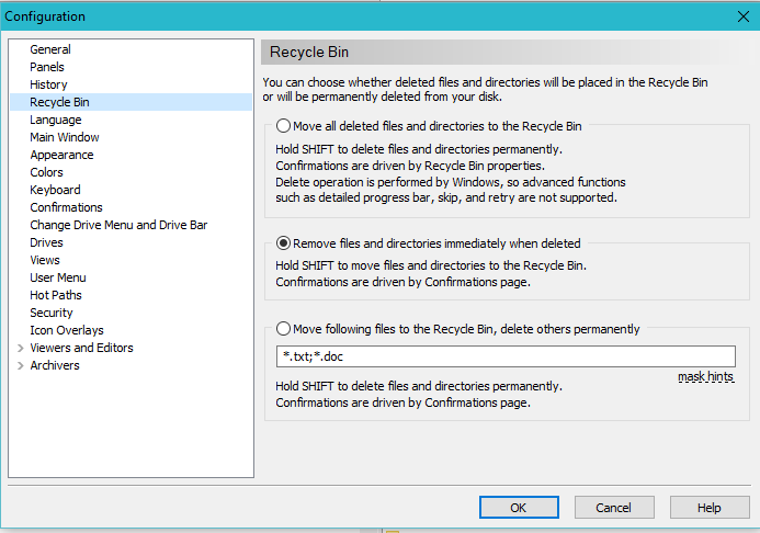

Thank you. seems to be working. However
The recycle bin option is a little confusing (to me)
I have selected the second option it was the top one.
Altap Salamander Setting.PNG (30.28 KiB) Viewed 30468 times
Which is considered best?
Re: Confirm DELETE
Posted: 13 Jan 2016, 13:34
There is nothing confusing about the 3 options.
It just manages what happens when you delete a file.
a) it is moved to the recycle bin where you can restore it if needed
b) the file is deleted immediately
c) files with file extension specified in the list are moved to the recycle bin otherwise deleted.
I am using the first option as it can happen that you delete something you did not actually want to delete and you can kiss that file bye bye if you delete it on a SSD drive. With the firts option you can still recover the file if needed. If I want to delete something immediately, I can still use the shift+del combination which does exactly that.
Use the "Empty recycle bin" option from the right mouse button context menu on the recycle bin to clean it up. Or just Shift+Del the "$RECYCLE.BIN" folder.
